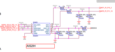

@snack wrote:
We suspect that there is a problem with our connection method.
In that case, you would see it in the raw data.
Have you compared against a known-good implementation - such as an ST evaluation/development board?
eg, STEVAL-MKI218V1
via: https://www.st.com/en/mems-and-sensors/ais2ih.html#tools-software

We have used the official code, but the measured values still do not match the actual situation. The most intuitive example is that when we apply acceleration on the X-axis, the X-value reads 0 while other axes show values. Could it be that our hardware connection method is incorrect? Could you please help evaluate it? Here is our schematic diagram.
Thank you very much!

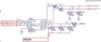

When we apply acceleration to the X-axis, the displayed acceleration value of the X-axis is 0, which is obviously incorrect. We have referred to the data sheet and official code, but still failed to find a solution. Here is our hardware schematic diagram. Could you please help evaluate whether it is reasonable? Thank you very much!
Note that everyone can see all replies - there's no need to repeat stuff to each contributor.
You can mention multiple people in one post using '@'
