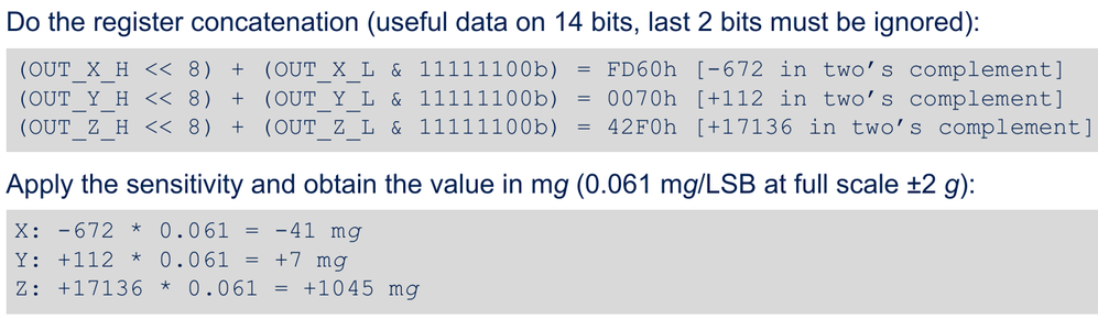

section "4.5.1 Example of output data" of the LIS2DUX12 device application note (AN5909) provides an example of calculating the acceleration value from the FIFO.
In the example 14 useful bytes from the FIFO are multiplied by the sensitivity in "mg/LSB":
I think "LSB" in the sensitivity refers to the sixteenth bit of the FIFO word.
Why aren't the raw values from the FIFO shifted right by two bytes (or divided by 4) before multiplication?

You mean 2 bits - not 2 bytes ?
@Andrew Neil wrote:
Yes, two bits.
