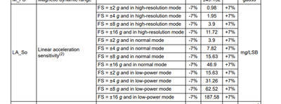

And should be changed, according to the datasheet, if the power mode changes:
