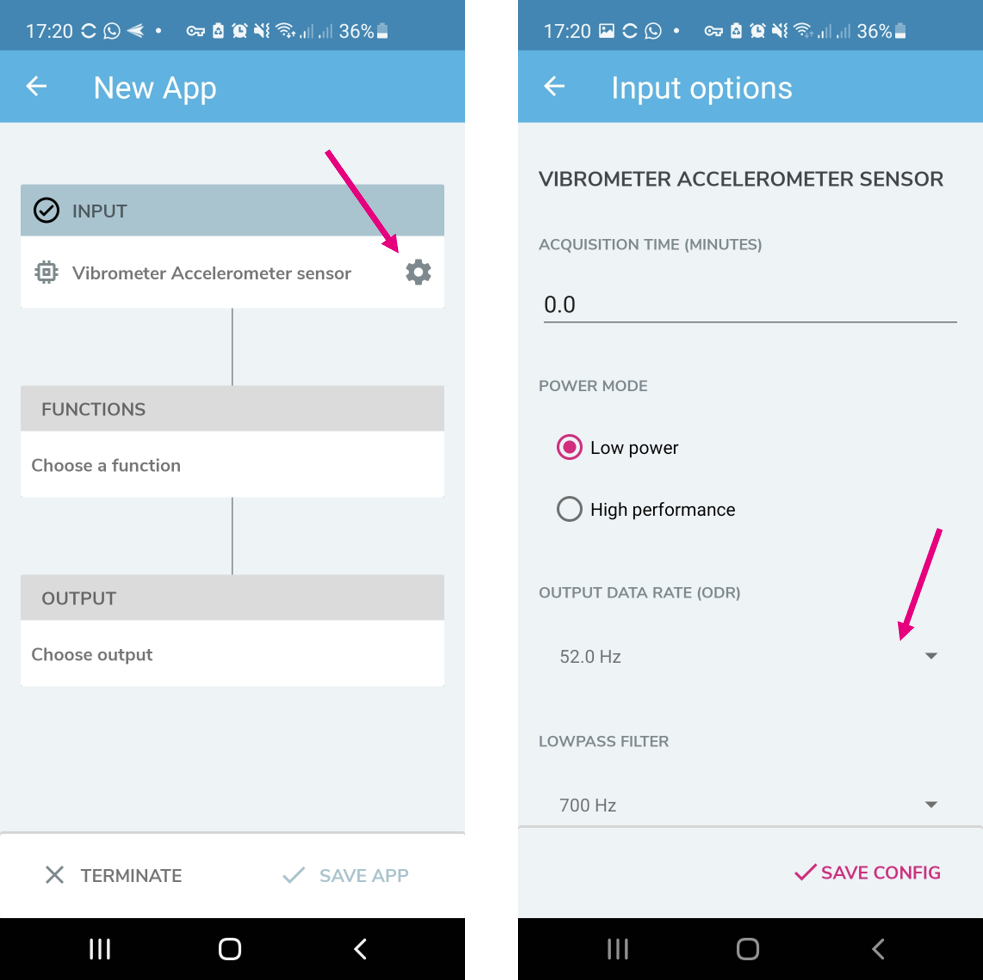

The easiest way to configure of the SensorTile.Box sensors is to use the STBLE Sensor app, selecting a sensor and configuring its ODR as shown in the picture.

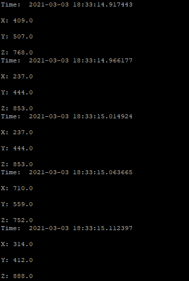

I tried to used that function changing the odr value several times, with different values, but when I read data, I got it every 0.05 seconds. Is there another parameter apart from odr? Maybe the sensors sampling frequency is being modify but not the frecuency data is updated.
I'm using a RPi 4 for the BLE connection. I modified the example_ble_1.py script from the STBlue sdk to read x,y ,z and timestamp. The output is the next:
Thanks

ok now I better understand that you were looking for the frequency at which the data is made available on the interface, and not strictly the internal device ODR.
Glad you have found the solution :smiling_face_with_smiling_eyes:
