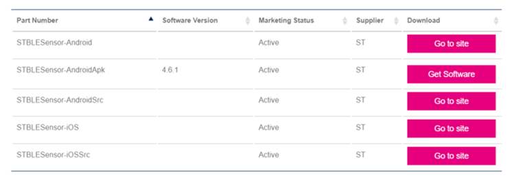

Hi @ACout.1 ,
I'm afraid this app is not available for Windows OS... From the app page on st.com the available versions are the following ones:
-Eleon
