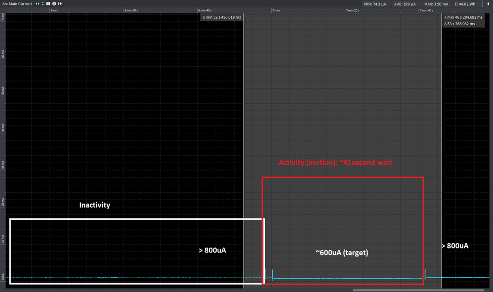

However, when the device enters in the INACTIVITY mode, I see power consumption rising from 600uA to 800uA, giving an increase of ~200uA. It should take the It looks like the LP_MODE and MODE of the CTRL1 register are not taken into account. However, when the device is moving (ACTIVITY), the power consumption is going down again.
0693W000007ZGcTQAW.pngI guess something is wrong in the configuration but I cannot find what. Documentation says that if the STATIONARY field is set, the Inactivity and Activity timer are using the values configured by default, but I don't think it is the case, the device seems to be consuming like it is in High Performance.

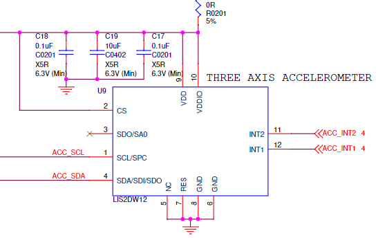

Since however the consumption is a little high, I would also check the correctness of the board schematic. In particular, how is the SA0 pin connected? By default it is an input with internal pull-up, so if you tied it to GND there could be over-consumption coming from this configuration. As stated in the same app note p.2, unfortunately internal pull-up on SDO/SA0 pin cannot be disabled: do not connect this pin to GND in low-power applications
Can you please check if this is your case?

I just checked and the SDO/SA0 and it is unconnected on the board. I missed that in the documentation. Would it be the root cause of this 200uA difference?
0693W000007ZOF3QAO.pngWhy does this generates only an increase when the accelerometer is not moving (Inactive state)?
Florian

it should not be the case, since if it is left unconnected it should be pulled high by internal pull-ups.
Which current consumption are you experiencing just after the power on of the LIS2DW12, just to check whether it is a matter of hardware connection or device configuration? Just after the boot the device is in power down and should consume less than 1uA.
Consider also that the CS pin is internally pulled up (datasheet, p.6), so if you are lowering it for the SPI communication you could experience an over-current consumption.
-Eleon

When we boot the device, consumption is low for 41 seconds (600uA), then the accelerometer enters in INACTIVITY mode and we see this power raise. When I move the device, the power goes back to the expected value.
Florian
Hi Florian,
then you might experience an extra consumption from the pull-up resistors on the I2C lines (that I cannot see in your schematic but that they are mandatory if you use the I2C interface). These resistors have to be connected to the VddIO line (a common value is 10kOhm).
In particular, if your Vdd and VddIO are tied together and you measure the current consumption on the Vdd node, during the I2C commutations you'll see also the current flowing from the VddIO through the pull-up resistors.

Hello Eleon,
We have 2 pullup resistors of 10kOhm, one on both lines of the I2C which are connected to the VCC_3V0.
When we start, we do not have overconsumption, it seems that the accelerometer is in the ACTIVITY state and after the 41 seconds of INACTIVITY we go back into the INACTIVITY mode and we overconsume.
Florian

I now have only the accelerometer set and have the behavior I described. When the accelerometer detects inactivity,
[00:00:30.082,794] <inf> LIS2DW12: activity handler (Inactivity)
<Overconsumption>
<Device is moving>
[00:11:27.765,808] <inf> LIS2DW12: activity handler (Wakeup interrupt)
[00:11:28.128,112] <inf> LIS2DW12: activity handler (Wakeup interrupt)
[00:11:28.691,711] <inf> LIS2DW12: activity handler (Wakeup interrupt)
[00:11:29.456,573] <inf> LIS2DW12: activity handler (Activity)
<Normal Consumption >
[00:11:50.146,209] <inf> LIS2DW12: activity handler (Inactivity)
<Overconsumption>
The HP filter is not enabled. Should it be enabled?
I do not get the question: " Cna you check if you are receiving data at ODR = 12.5Hz during the inactivity phase, to check if you are actually in low power mode?". How can I check that? Should I read the registers in the inactivity state ?
