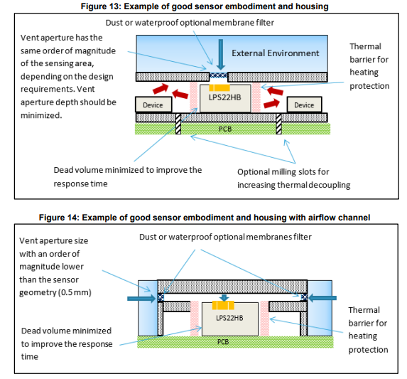

Hi @PBart.2 I agree with clive1 that it is better to contact ST regional FAE. Btw, if the specific pressure sensor is not water resistant or waterproof such as the LPS22HH, the washing process is not recommended. Well, the device could withstand the direct exposure to the washing flow with a good statistics, but it cannot be guaranteed 100%.
On the other side, if your application embeds a water resistant protection structure as described in the AN4672 (p. 14), it's another matter. Regards
