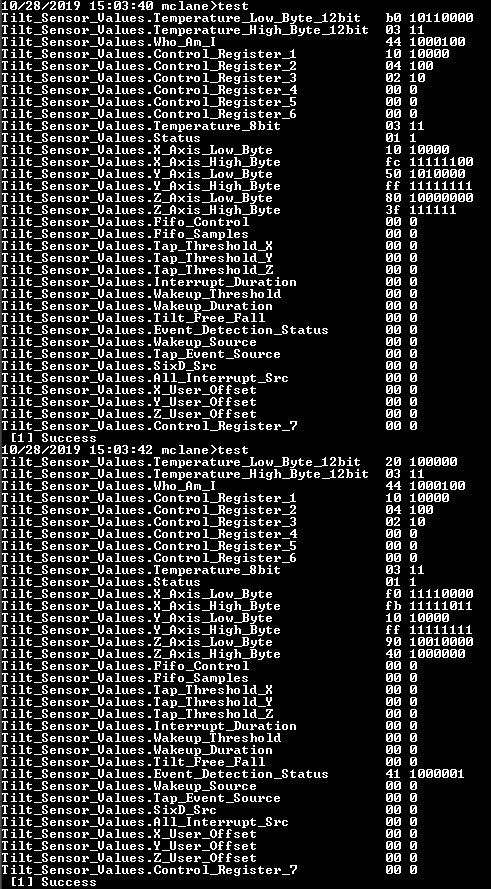

I am trying to periodically poll the IIS2DLPC for X Y and Z values, and then convert them to a tilt value. The evaluation board is just sitting on my desk not moving, so I thought that the values shouldn't be changing (at least not changing much), but every reading is different.
I did some googling, and I see that linear accelerometers usually output euler angles or quaternions. I assumed the X Y and Z values were euler angles, but regardless of the unit of measurement, I still can't figure out why the values are changing every time I read them when the sensor is not moving at all.
Could someone give me a little guidance on parsing the X Y and Z data output registers?

}IIS2DLPC_REGISTERS;When I run a function that reads and prints each register, I get what I expect in the registers that I have written to, and the "WHO_AM_I" register, but the X Y and Z data is different every time I call my function "read and print every register" function.
If you look at the attached image, this is me calling this function twice with a few seconds between each call. Notice the temperature and XYZ data changing. I am printing the HEX and binary representation of each value (sorry for the lack of labels).
