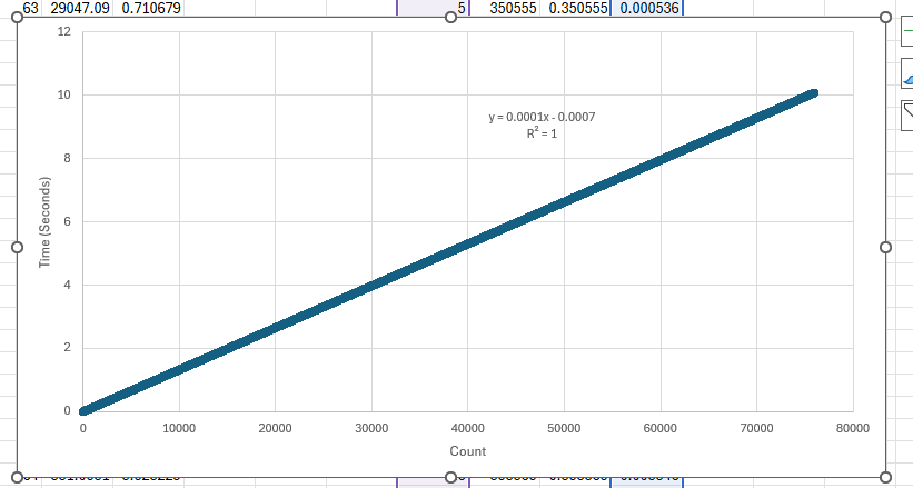

The processed log said that I had a 10.3 second record length.  This is a plot of the time output in the record log against the record number.  It has a R squared of 1, that is impossible on electronic data, this is a C++ program output.

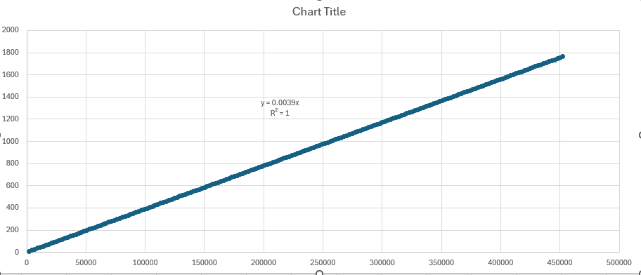

Next is the same plot with the real byte data from the acceleration dat file.  This is an analysis in EXCEL.

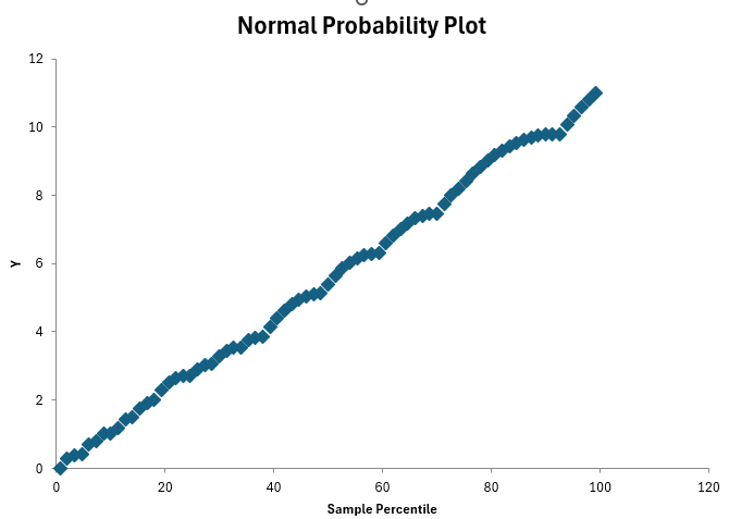

Notice the secondary wave or Fourier series.  If I show the NPP
The NPP shows the Fourier series on the linear regression. It is normal data as expected, there is a minor load but the non-Gaussian element is not of concern.

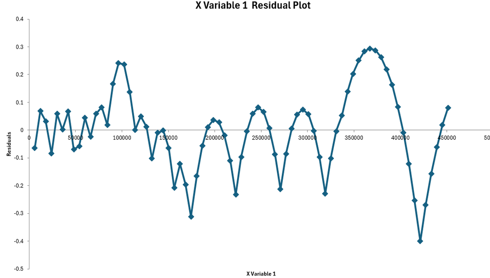

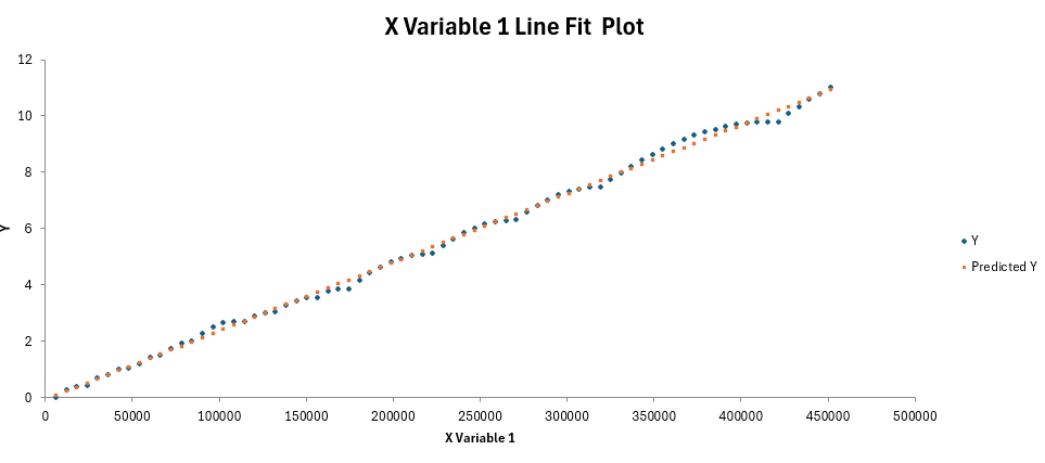

The residual plot shows why your first plot is nice, but it is based on the theory that the records all occur equally spaced, this says otherwise.  I am sorry, but one believes  the data and not the theory.
The linear regression from EXCEL shows the zero is almost a zero but not quite and the slope is so defined the error is close to zero, really close to zero.
 CoefficientsStandard Errort StatP-valueLower 95%Upper 95%
Intercept-0.082480.034077-2.420470.017989-0.1504-0.01457
X Variable 12.44E-051.29E-07188.49857.1E-1002.41E-052.47E-05

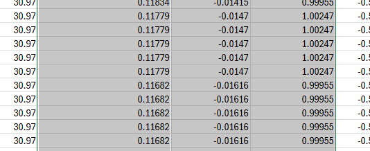

So I uploaded the data from the MEMS Studio file and attempted to align the output with the byte output from my program.
It works for a short number of entries and then fails.
If I have the total bytes, I subtract out the four zeros at the start, the jump and timing data I get a number that matches the data left over in the array.
You have 729 extra data points.  At first I thought you were adding data into the timing signal <that was a long hard look>, but no it is not in the correct format.  So I looked for duplicates in your data as you had too many points so they are either random stuff or duplicates.  About every 76 steps if I take the sum of your data in row n and row n+ 1 and subtract them I get a zero.
We have collected acceleration data for the best part of 20 years, I have never seen duplicates, it breaks all of Newton's laws of physics, and I should not have to explain why.  This gives the extra 729 steps over the byte count for your data.  My catch function is coarse so it may find an odd false, but not like this table.

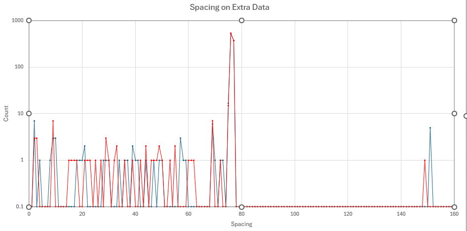

i have now done the second data file. The blue is the spacing on the first file for the extras and the red for the second file.  The 78 and 79 match exactly on the count, this is statistically unlikely.

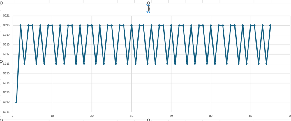

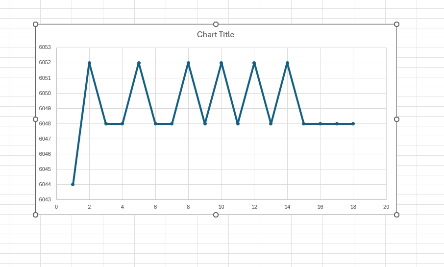

This is almost the step function for the timing, I made a mistake at 17 it should be 6052, I have fixed it but too lazy to get a new snap.
I have not found the repeat yet as I only go to 18000 records.
