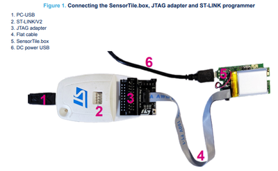

1. connect the sensortile to PC via USB and STLink as picture with battery unconnected

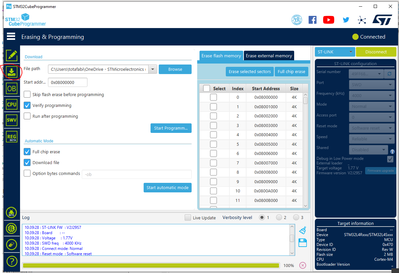

3. connect to the sensortile, now can you see the flash memory content
click the second icon, browse the BLEFOTA_BL_1.0.0.bin file in the FOTA folder (https://www.st.com/en/embedded-software/stsw-mksbox1-bl.html) and set all parameters as in the picture below:
4. start program
