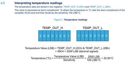

may i know lps22df temperature offset register?
want to read the correct value at 25 degrees in the temperature chamber,
but it seems to be read as an incorrect value.
2024-12-17 6:37 PM
The data sheet will have information on how to read out the temperature, including the register addresses.
What value does it read? What value are you expecting?
