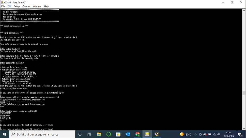

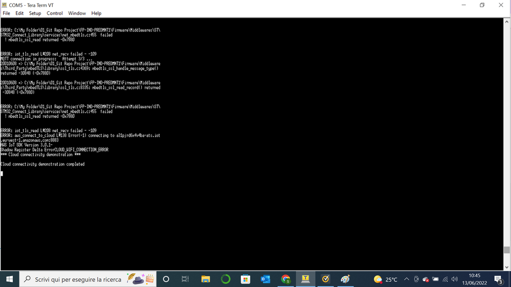

I have the STEVAL-STWINWFV1 Wi-Fi expansion and the board connects to the network correctly.
However, when I try to get the board to connect using TeraTerm according to the instructions described, I get the error below:
Frankly, I have no idea how to fix it, so I really hope you can point me to a solution.

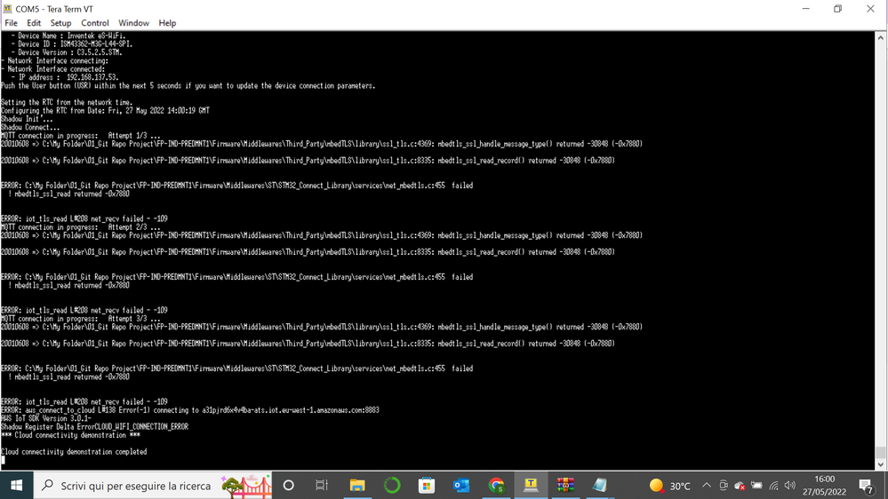

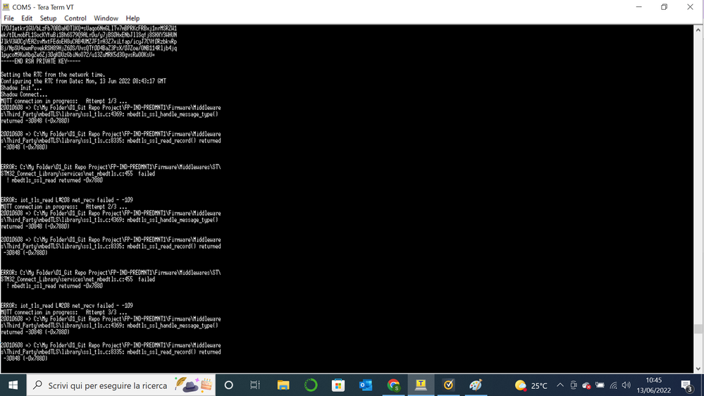

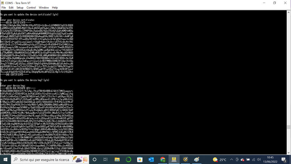

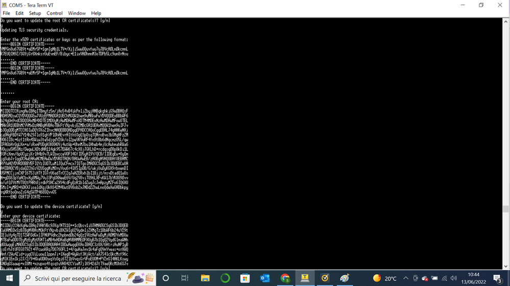

2022-06-13 1:53 AM
I have tried several times to delete the device from the Dashboard, but as soon as I update the page, the device is again associated with my account.
I have verified that my network is 2.4GHz, so I can confirm that.
Clearly I pressed the USR button to insert the certificates, below I report the complete log:
