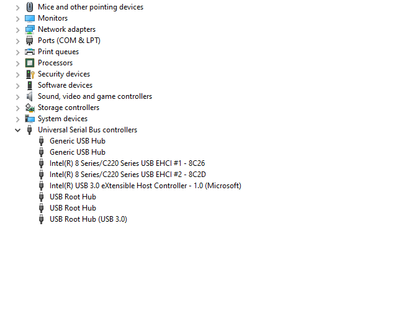

Thanks for getting back to me. I followed the guidelines while writing the post, but I'm still having trouble. My PC isn't recognizing any USB connections to the STWINKT1B. I attached a screenshot of the device manager for you to check out while the STWINKT1B is connected via USB.
I even tried another STWINKT1B on a couple of different PCs, but the issue persists. The device powers up fine (the LED lights up), but Windows isn't recognizing it.
Any suggestions would be appreciated. Thanks!

Regarding my inquiry, it appears that all three cables I was using were faulty for data transfer, which is strange. Fortunately, I managed to get another cable, which resolved the issue.
