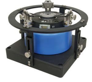

I can share some data regarding bandwidth measures via private message, where each point of the file is the RMS value for the specific frequency.
As test bench for BW characterization, we use a shaker from Spektra and a laser vibrometer for closing the loop. The shaker is like the one here below:
-Eleon
