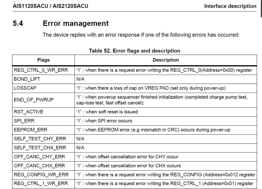

1. END_OF_PWRUP bit in the REG_STATUS_0 is 1 constantly throughout selftest mode and normal mode. Is it normal? On the page 55 of the datasheet, it says it would reply error frame if the flag is on. However, I don’t see any error frame during the flag (END_OF_PWRUP) is on.

1. As reported in the datasheet, p.18, the END_OF_INIT should be reset to "0" before starting the Self test procedure, or the configuration procedure;

Thanks for the reply. After soft resetting the sensor, the END_OF_INIT is 0, and then the initialization phase(0b00) will transition to test phase (0b10, which indicates it's in test phase and END_OF_INIT = 0.) I am certain that the actions of selftest and disabling the offset cancellation are before END_OF_INIT bit is set to 1.
If you attempt to write REG_CONFIG and REG_CTRL_1 in Normal mode (0b01, END_OF_INIT =1), it will generate error frame when you request X or Y acceleration data. (status = 0b11), I checked the status for every acceleration frame to make sure I was reading the sensor value legitimately,
