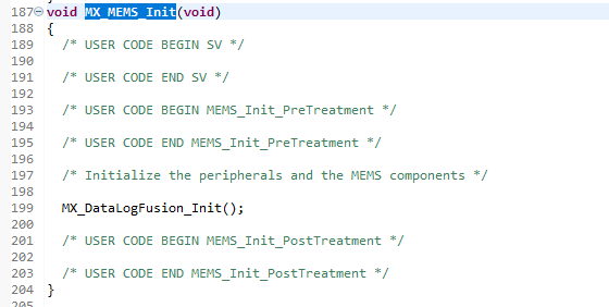

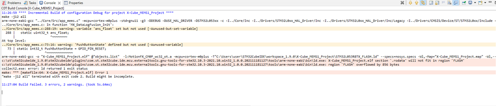

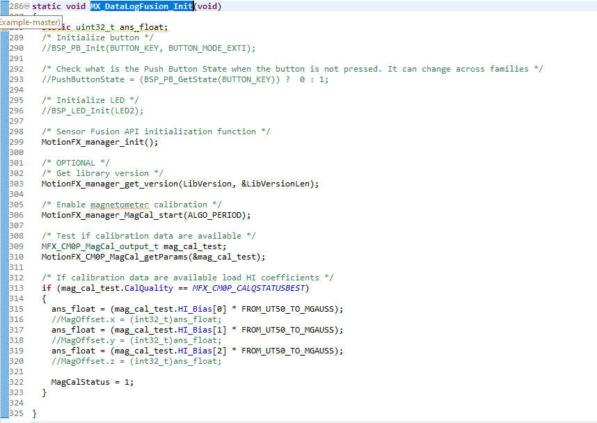

Hi @Petr S_O ,
Thank you for the reply,
I've tried using MEMS_Init function attached below. But now I'm observing FLASH Overflow error. I have not used BSP type functions. Is there any setting/process to overcome this error. Go through the attached images and Please help me to resolve this error.
Any help would be very thankful.
2022-06-01 2:57 AM
L0 has very limited memory and MotionFX is quite demanding library so it's not the best combination. If you haven't already tried you can turn on the optimization for size and also try to avoid using too many global variables initialized to the non-zero values. You can use the DataLogFusion application for Nucleo-L073RZ in the X-CUBE-MEMS1 package as a reference.
