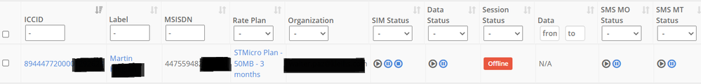

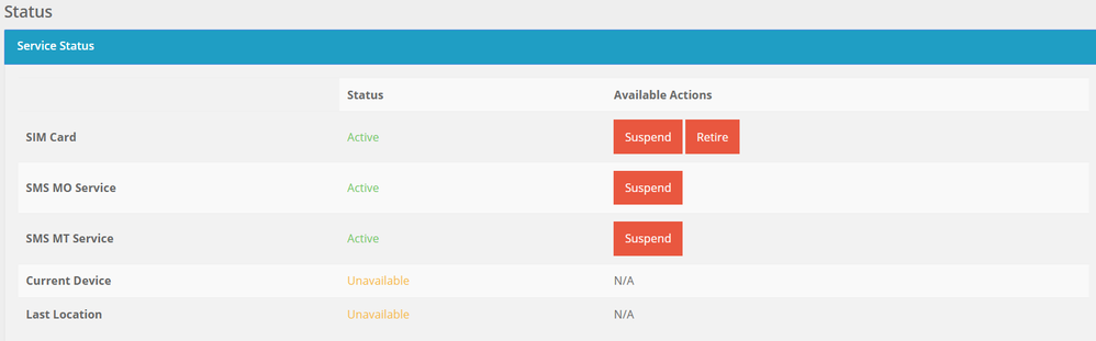

I am using a SIM7080G module along with the eSIM model ST4SI2M0020TPIFW, and when I use the AT+CCID or AT+CPIN? commands, the module responds with "+CPIN: NOT INSERTED". I have followed all the steps in this tutorial to activate it, and I managed to do so, but I find that on the Truphone page, the session status of the eSIM, despite the SIM status being activated, as shown in the image I attached at the end, is it possible that the SIM7080G module cannot recognize the eSIM because I apparently activated it incorrectly? Should I only follow the steps in the application note I attached to use the eSIM and make calls or connect to the internet, or do I need to perform any additional configuration with a local operator in my country? I hope you can help me.
