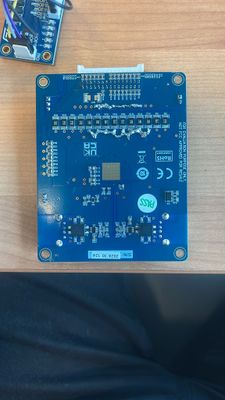

During previous testing, I shorted some unused sense nodes with thin wires in the BMS board pins. The measured DC voltage difference between the unused sense nodes was around 0.02 V, but when connecting or switching the DP711 supply, a sense wire burned and the L9963E IC became very hot. This suggests that the issue may involve the physical holder current path, transient current, incorrect sense wiring sequence, or sense wires accidentally carrying charge current.

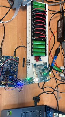

PS: here some images of the sense part got connected and the other one showing the exposed part that got burn

Just to follow up, I am using 6 Cells now as attached below, connecting cell 1-4 and 13-14
The unused cells show approximately:
Cell5–Cell12 ≈ 0.01–0.02 VIn the AutoDevKit configuration, I enabled only the active cells:
Cell1, Cell2, Cell3, Cell4, Cell13, Cell14I disabled:
Cell5–Cell12I also modified the application code to prevent balancing on the unused cells. In the GUI, balancing appears active only for the enabled cells and OFF for the unused cells.
When the board is connected but the L9963E is not active, there is no obvious heating.
However, when the MCU activates the BMS / L9963E starts operating, the board begins to heat. The heating appears to start around the JP1 area, especially around the RG / CGS / RPD jumper region. and also around P3 in the other edge and around senses of Cell 13 and 14
I tested different JP1 positions and even removed the JP1 plug, but the pins/area still become hot when the L9963E is active.
