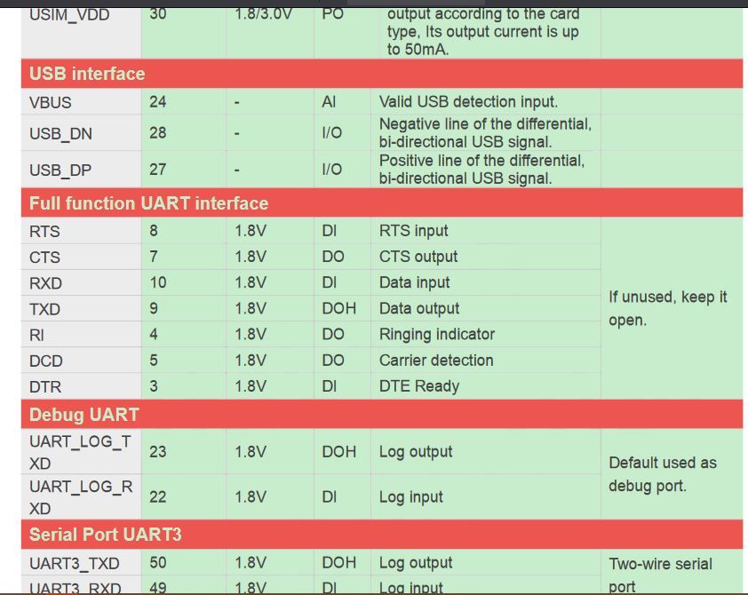

Hello
The code should work if UART is properly initialized (HSE value)
Also A760 has 1.8V levels UART
Note that the code initializes UART in DMA mode but HAL_UART_Transmit(...) dont uses DMA or interrupts. Is the blocking version of transmit
