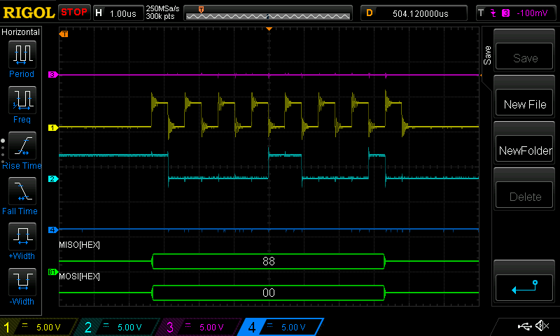

I checked the signal in my oscilloscope.
In both cases the MCU is transmitting correctly in the MOSI line.
I found what I think is a problem in the MSIO line in my custom board :
Looks that MISO line is shifting when clocks idles back to 0. Like there is some kind of delay. The slave is listening ok in the MOSI line, therefore sending data but the slave response gets somehow delayed. I guess the problem is somewhere in my board.
And just for you info, I have the same behavior with another custom board and even in another SPI. ATWINC uses SPI3.
Do you have any recommendations ? Where should I look (soft, hard)? I am really desperate, I do not know even where to look now.. All suggestion are welcome.

2021-02-06 2:30 AM
Hello
>>This SPI message is the same as p121
This is not the same
In p121 CS pin is pulled high between tranmission and response but the code transmits and receives under the same CS pulse
