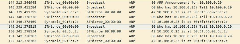

When I press the switch to start the TCP transmission, I do not get past the ARP.
WireShark Results example:
60 ARP announcement for 10.100.0.20
60 Who has 10.100.0.23? Tell 10.100.0.20
42 10.100.0.23 is at 50:3f:56:02:5c:2c

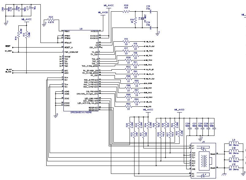

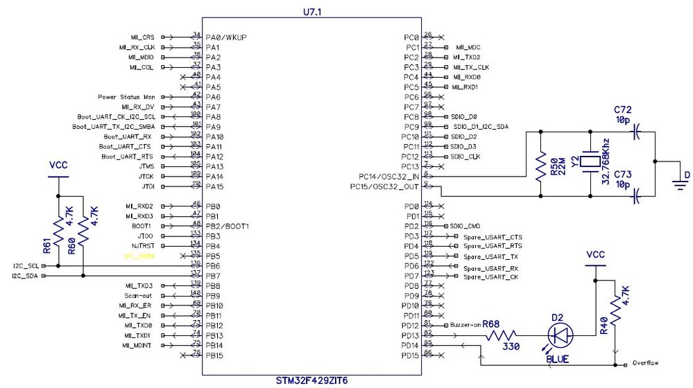

I wanted to add the Ethernet Portion of the schematic.
Also the Wireshark Image.

I found a solution to my problem.
R98 which is connected to the MII_RXD3 line was a 4.7K Resistor not a 33 ohm resistor.
After changing that resister to a 33 Ohm the Ethernet started communicating.
