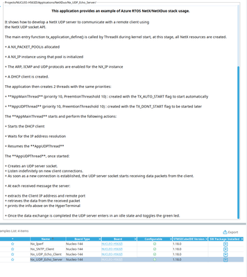

Hi, I saw your project - unfortunately I do not have a H563 board to run it, but from code it seems you set up everything but program does nothing ...
I suggest you run one of the provided examples - it is an easy path to start with.

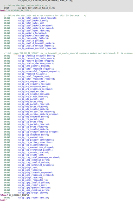

Later you can monitor network activity - NX_IP element has ( and in your design are enabled) a lot of activity counter.
Also Threads list can double check if all your task are running and where they stop.
