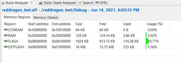

hello, I"m trying to develop an application for LCD using stm32f407. the application requires graphical data that we are trying to save in external nor flash. the nor flash is connected to uC over FSMC interface .we are using stm32 cube ide for programming and can see the data allocated in an external flash under "memory regions".now we need to be able to flash the program this into external flash so that uC can access it while running its code.
however, we are unable to find any app notes or snippets for the same.
we have found how to do this with QSPI but we want to access using FSMC only.
any help would be greatly appreciated .
