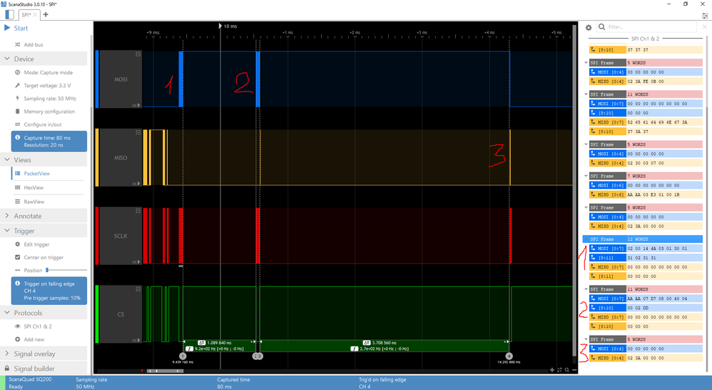

For the people who would have an example of the SOCKDW command timing:
1) SOCKDW command
2) data payload
3)
AT-S.OK
SPI run at 8MHz, nHost interrupt line is not shown but CS line can give you an idea of the interrupt request timing.
The content of the frames are on the left panel.
I can't explain what take so long to the SPWF04SA to send few bytes.
