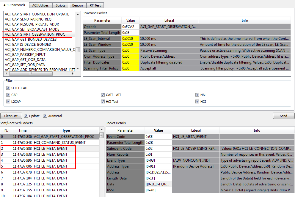

I am currently trying to scan and log advertisement data using STEVAL-IDB007V1.
Advertisement data will be coming out of separate BLE compatible module.
Would this be possible using BlueNRG GUI and python script?
Could anyone point me to a right direction for this?
Thank you

Hi KC,
Yes, it is possible to use BlueNRG GUI or script to scan and log advertisement data.
With GUI,
1. in ACI Utilities tab, click ''Init Device''
2. in ACI Commands tab, send ACI_GAP_START_OBSERVATION_PROC
3. Advertisement data will be presented in HCI_LE_META_EVENT
Regards,
Winfred

Thank you so much, Winfred!
