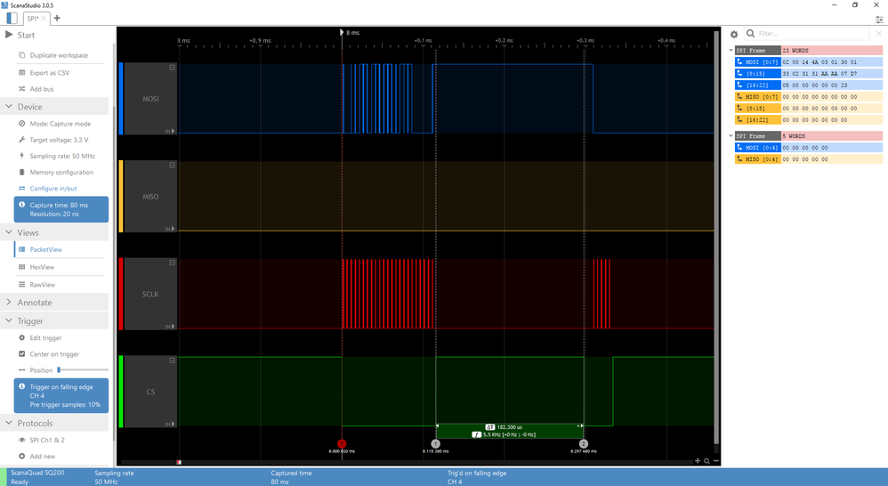

So, the upgrade goes well but does not solve the SOCKDW issue as you can see on the picture:
I don't understand why I have an interrupt and 00s after I send my command and the payload. It cause bad behaviour in my application and stuck it.
