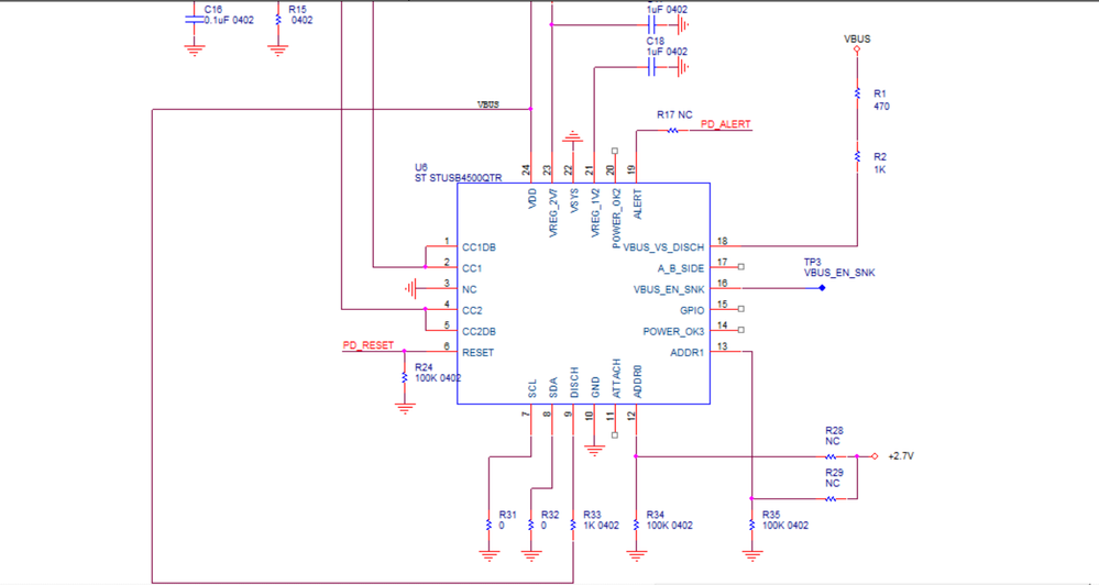

I connected type C with this circuit and measured VBus got 20V, then a few seconds later stusb4500 broke down.
Anything i have lost in this circuit then made it broke down? How to fix this circuit to get 15V in VBus?
 Thanks in advance.

Hello
By default, stusb4500 has 3 PDOs: 5v/1.5A - 15V/1.5A and 20V/1A.
Thus if source_capability has a PDO@20V with at least 1A, contract will be negociated @20V.
If your system needs to be supplied at 15V or below, during your production, you need to re-program stusb4500 NVM by removing 1 PDO.
If your system needs to be supplied exactly at 15V, during your production, you need to re-program stusb4500 NVM by removing 1 PDO and setting POWER_ONLY _ABOVE_5V.
