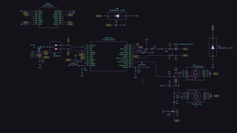

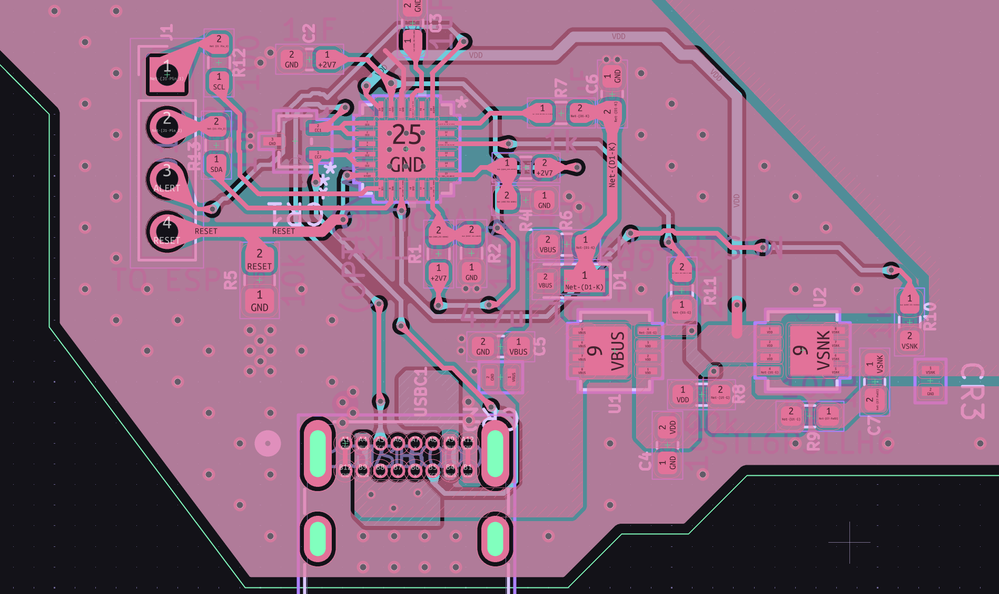

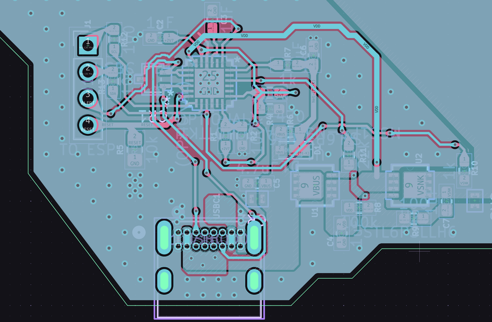

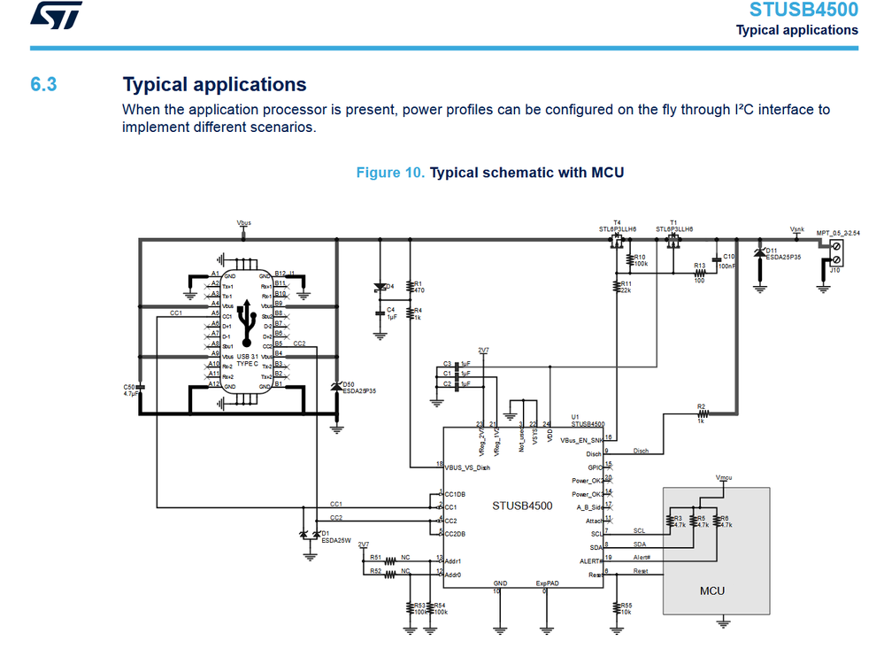

I am a student doing a capstone project, and I have been having a massive headache with the STUSB4500 PD negotiator. I am using it to pull 15V at 3A from a power brick so I may power a handheld device downstream. We utilized a recommended layout from the datasheet itself so that we may program it ourselves. Attached below.
The good news is, it can sustain loads and power our project... but the bad news is these chips have up and died about as randomly as a carnival prize goldfish, attached are pictures of my layout and schematic for this section of the board. Apologies for any amateurish mistakes on schematic labelling and layouts.

I wouldn't know. I see no recommended schematics on the STUSB4531 datasheet anyways.... I went to check recommended layouts for the STUSB4500 only to find my layout seems to be fine when compared to sparkfun's board and the devboard for the STUSB4500... I really need help with this, my degree kinda depends on it...

Your schematics are correct except capacitor C7 should be 100nF instead of 1µF.
