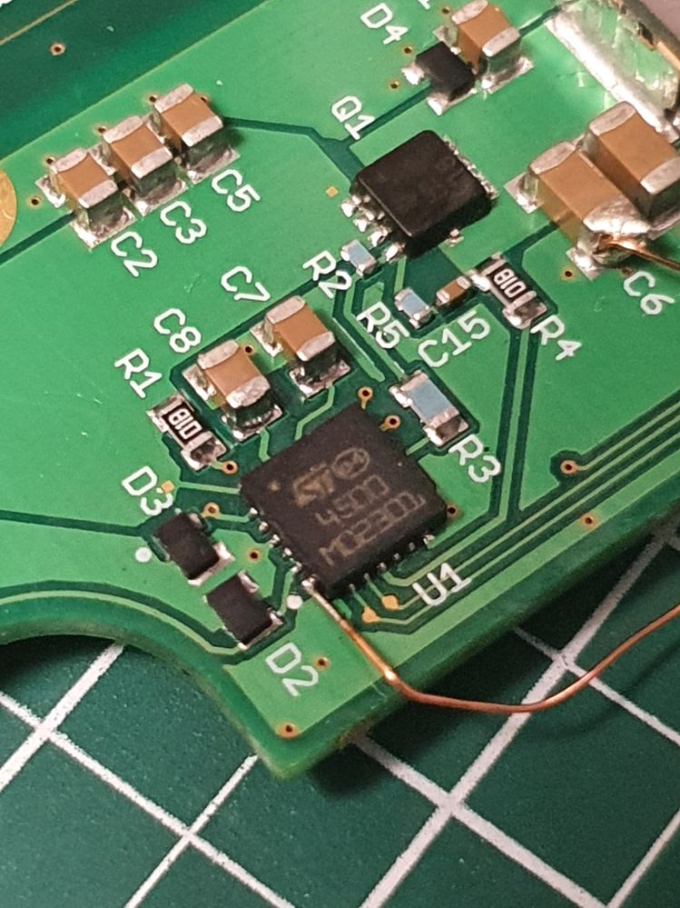

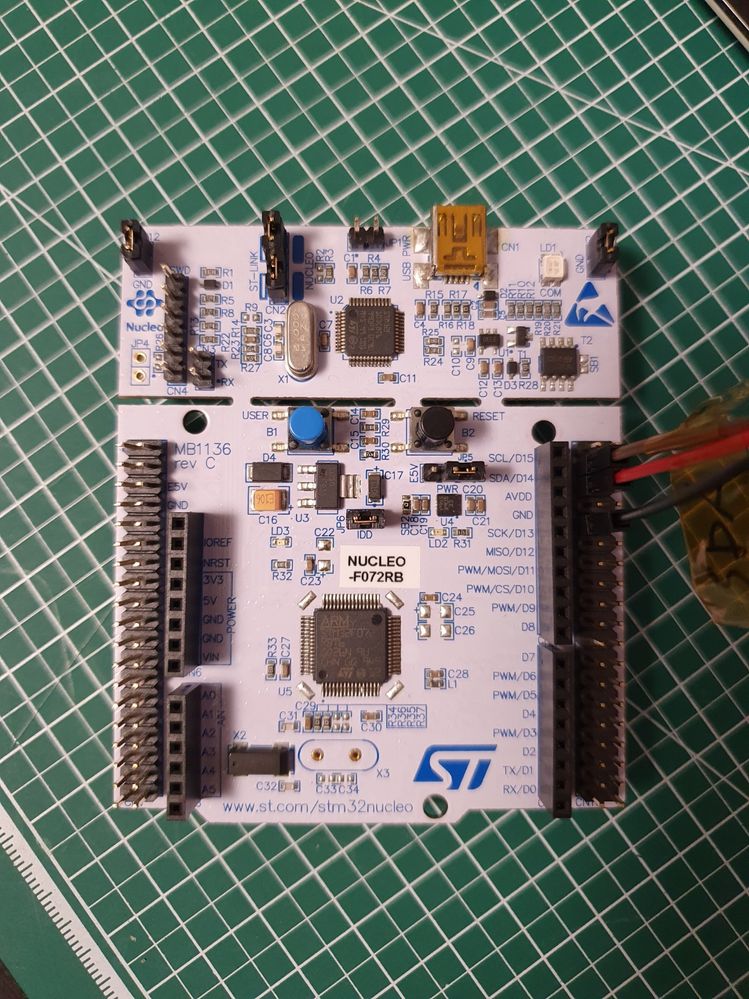

2021-02-08 5:56 AM
Thank you Winfred, Greg,
I tried connecting the Nucleo-F072RB SDA, SCL, GND to my custom board, but the tool is giving me the I2C Read error. error number: -2.
I'm assuming this error is caused when the Nucleo board can't read the data from the STUSB4500.
My board is almost identical to the EVAL-SCS001V1 board, and there's external 4.7k I2C pull up resistors to 3.3V.
Do the I2C lines have to be pulled up to 5V?
I attached my schematic for your reference.
