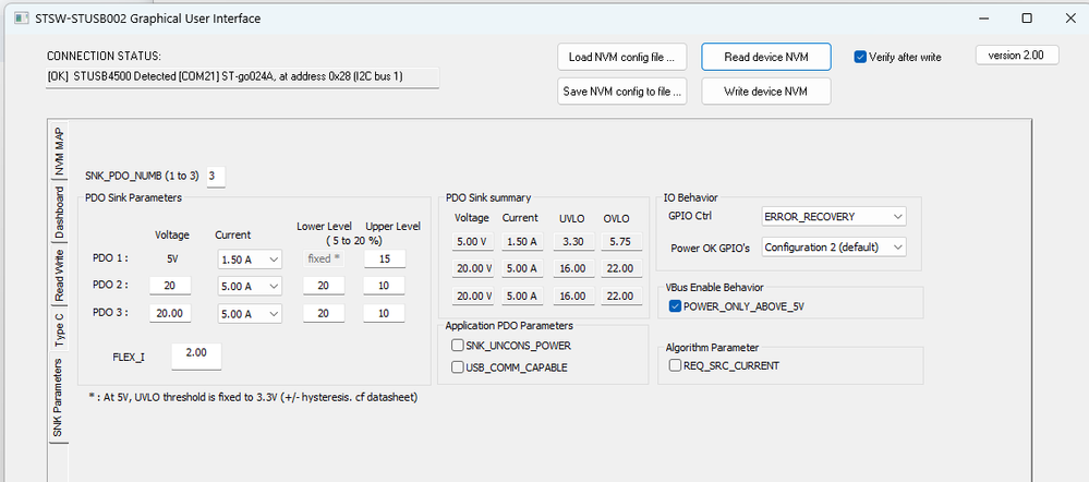

I am using the STUSB4500 to power a device with a large inrush current. I have configured the PDO's for 20V @5A which should be more than sufficient to meet the power requirements. I have selected POWER_ONLY_ABOVE_5V so that it will not attempt to power the device at 5V (which would draw 4 times as much current). See my settings below:

Note that instead of programming PDO2 and PDO3 with the same values, it is safer to set the number of PDOs to 2.
