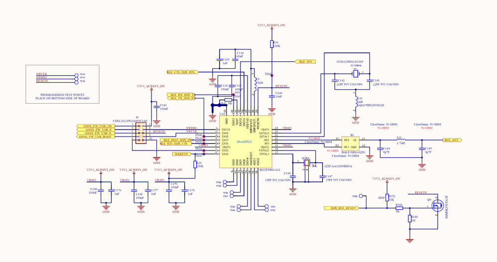

2022-11-23 2:54 AM
Please find a copy of the schematic. The BlueNRG-2 chip is connected to our main processor which runs Linx. we use hcitool commands to control the Bluetooth chip. also I set the

2022-11-23 4:38 AM
Thanks for sharing.
Nothing obvious looking at your schematics.
Could you eventually share Low and high speed Xtal ref?
Have you checked AN4818 and xtal centering?

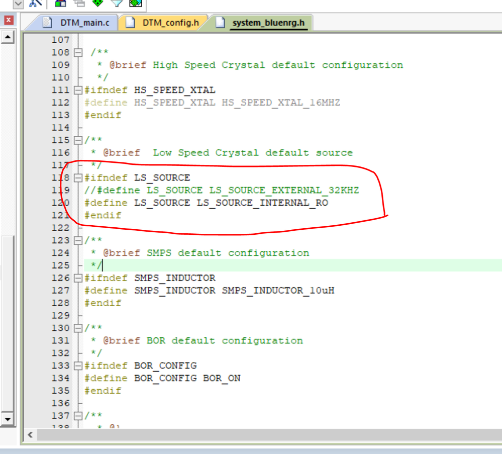

Did you try not using your 32kHz xtal (setting LS_SOURCE_INTERNAL_RO source)?

2022-11-23 7:02 AM
When I set the low speed clock to internal as shown in the screenshot, I wont be able to communicate with the device from the main processor though UART. also you can see the Hight speed clock there, but is does not seem to be defied. I have asked our hardware engineer to look into the clock centring

Please note when testing intyernal RO instead of external 32kHz you should set LS_SOURCE_INTERNAL_RO directly in pre processing options.
