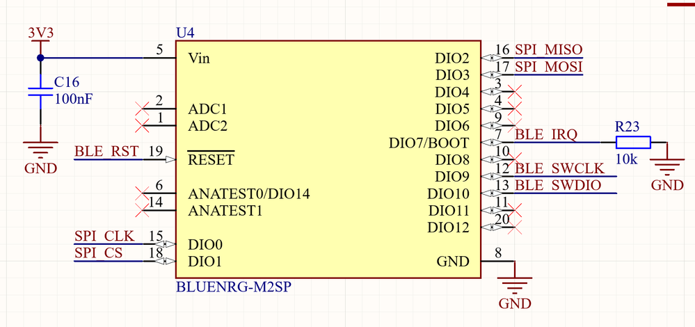

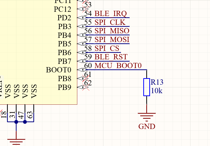

I'll attach the schematics because maybe my pins are connected wrong? I'm really at a loss and for the past couple days have been trying to test everything I can to no avail. Anything would be useful, Thank you!

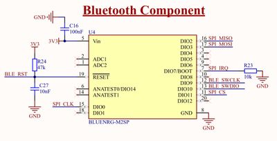

My problem that I found was that the CS pin for the v2.1e DTM stack was routed to pin DIO11, when I had it on DIO1. Since you already tried both, I’m not sure if that’s your issue.
I used the DTM stack found on BlueNRG-M2 -> Tools & Software -> Utitilies. I used the BLUENRG-M2SP_DTM_SPI.hex with the correct pinout and that fixed the communication. This is my final schematic for the M2SP for the project.
