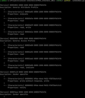

Hello @Imen.D, thank you for your response.
I am currently developing a simple PnPL command sender for the STEVAL-STWINBX1 board. I have already written a script that can retrieve the get_status of each component and start/stop logging. This script works correctly on Linux (tested on a Raspberry Pi).
However, I am experiencing issues when running a similar setup on Windows. Specifically, the board appears to “crash” (or enter an unresponsive state). The green LED stops blinking and may remain either ON or OFF indefinitely. After this happens, the board no longer responds to commands.
I observe the same behavior when sending the wifi_config*connect command (ST BLE Sensor Android app configuring wifi connectivity also did not work). Even when valid wifi_ssid and wifi_password are provided, the board stops blinking its LED, but it never successfully connects to the router.
To verify BLE functionality, I used my smartphone as a bluetooth device, and I was able to retrieve services and characteristics successfully (see attached screenshot).
Based on this, it seems the firmware is running, but the issue may be related to how commands are sent from Windows or how the board handles them.
Could you please advise what might cause this behavior, or what additional debugging steps I should take?
Thank you in advance.
