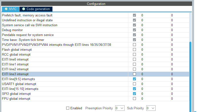

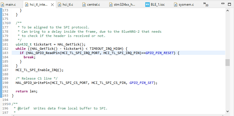

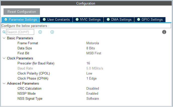

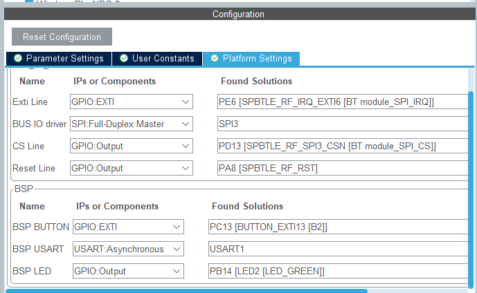

It is stuck in here for BlueNRG-2.BlueNRG-2 configuration I made like this.
SPI configuration
NVIC configuration
Could you guys please check it. Where is the problem?

2023-05-24 1:33 AM
I beleive that the interrupt is inactive at this line, the HAL_Get_tick function return the value of systick timer, if the interrupt is disabled, the timer value won't be changed
