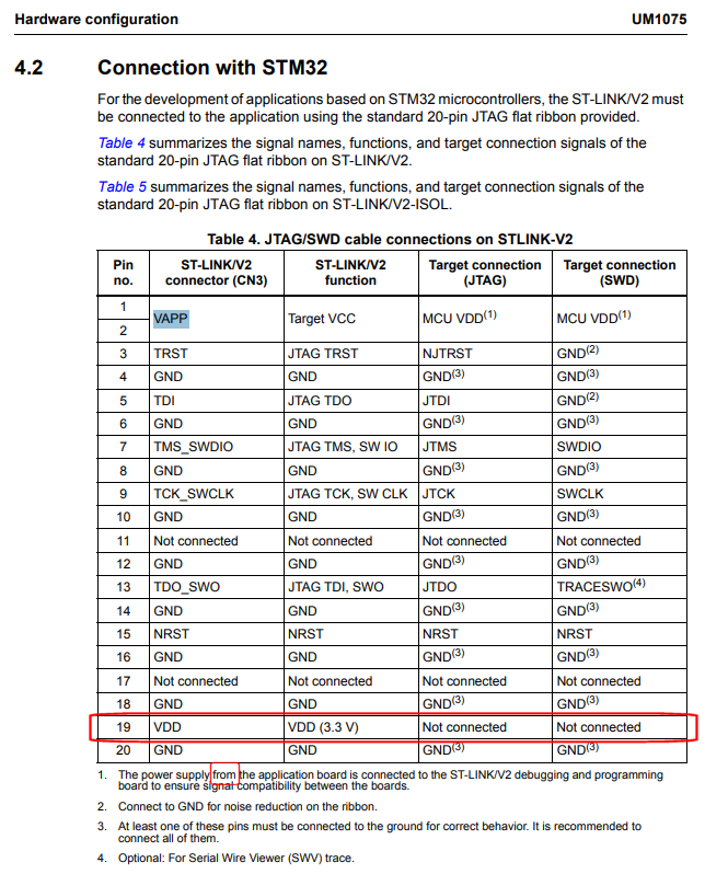

>> Is there any pin on the ST-LINK/V2 20-pin connector (CN3) that can be used to supply power to the target device during programming? Or is it mandatory that the target board provides its own supply (VDD) to the VTref (VAPP) pin?
As mfgkw wrote above: no.
Please check the ST-Link user's manual section 4.2:
There is a VDD 3.3V on pin 19, but please don't use it, it is not designed for power supply.

So your target's voltage VDD (maybe 3v3 or something below) must be connected to pin 1 or 2 of ST-Link's 20 pin connector CN3, This is VAPP: the voltage of your application, connected to ST-Link. It is an input pin for ST-Link.
It's level while unconnected has no meaning on ST-Link side.
Ignore pin 19. This is neither suitable to measure the target's voltage nor to supply anything. It is simply irrelevant.

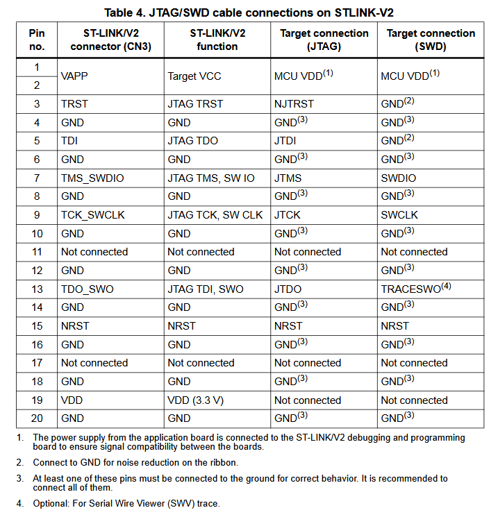

@Mike_ST wrote:There is a VDD 3.3V on pin 19, but please don't use it, it is not designed for power supply.
The User Manual could be a lot clearer about this:
It does, indeed, show that it should not be connected to the Target - but gives no indication as to why, nor what purpose this pin does serve.
Also, the description of VAPP could be a lot clearer that it's an input to the ST-Link from the Target.
This is such a common question that it really should be made clearer!

see manual:
So always (!) you have to connect pin 1 (and/or 2) to target VDD. (st-link check here VDD of target = ok ?)
+ usually have target powered by external supply.
And -no guarantee- pin 19 to get some 100mA max. for target supply. (only for small target, < 100mA !)
