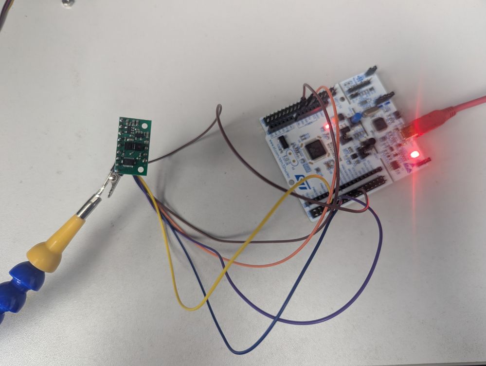

Hi, this is Kevin from Pololu. I can confirm that our VL53L8CX carrier does work with SPI. We have tested it with multiple controllers, including an ST Nucleo-F411RE running the CubeIDE_F401RE_Example_SPI code from the ULD API (STSW-IMG040):
We generally recommend keeping the wires as short as possible, but I specifically used longer ones here (12 inches) to demonstrate that it still works.
Our carrier board is intended to let people use the sensor with 3.3V and 5V controllers, and it was never intended to work at lower voltages.
