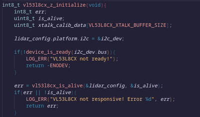

So I'm trying to get the VL53L8CX ToF lidar working in ZephyrRTOS running on a NRF9151 chip. I'm using the VL53L8CX ULD driver version 2.0.1. The VL53L8CX is connected to the NRF9151 using i2c with the address 0x52, however when I call the vl53l8cx_is_alive() function from the driver i only see the messages being sent over i2c and getting a NAK.

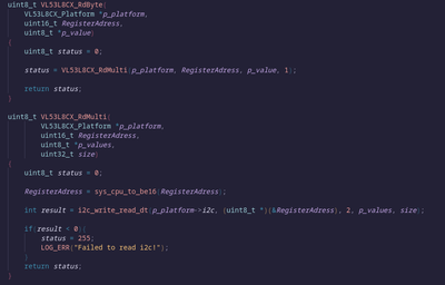

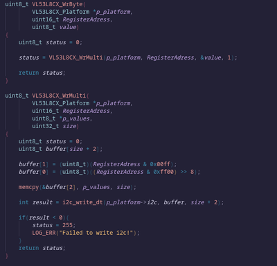

As we are using ZephyrRTOS and the NRF9151 I've had to implement the platform layer functions for i2c myself. I've used the VL53L1x driver that was already present in the ZephyrRTOS repository as the reference for this.

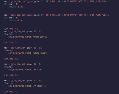

Additionally, we have purchased a x-Nucleo-53L8A1 development board to use with our NRF9151DK development board. When using this setup we are manually setting the lpn and power-enable pins high before calling the is_alive function. We have tried various gpio_configure flags without success.

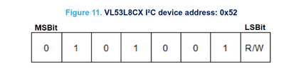

The datasheet says it uses 8 bit addressing, but it looks like that just means 7-bit address left justified with a r/w bit on the LSB. Which unless I'm mistaken is the default behaviour of i2c in Zephyr and most i2c.

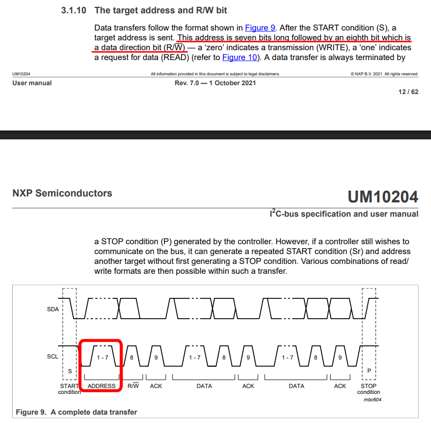

@RobinSuneti wrote:The datasheet says it uses 8 bit addressing,
That's just plain wrong. I2C addresses are, by definition, 7 bits; the R/W bit is in addition to the Address:
https://www.nxp.com/docs/en/user-guide/UM10204.pdf#page=12
Unfortunately, this is an extremely widespread mis-description and source of endless confusion:
https://www.avrfreaks.net/s/topic/a5C3l000000UXMPEA4/t142031?comment=P-1150738
The other question is how the Zephyr software driver expects the address to be presented.
Software authors & documentation are also notoriously bad here.
#I2CAddress

@RobinSuneti wrote:Looking over the datasheet for the vl53l8cx it says the lidar should be 0x52 and 0x29 is not listed as an alternative address.
They are the same thing, shifted:
0x52 = 0 1 0 1 0 0 1 0
0x29 = 0 0 1 0 1 0 0 1
2025-06-20 8:46 AM
And that is the problem with the I2C bus definition of addressing.
The 0x29 is the base address. To get the write address, the base is shifted one bit to the left, and a zero is in the LSB.
To get the read address shift the base one to the left and set the LSB.
So 0x29 => 0x52 and 0x53. The base address becomes the write and read pair.
But when writing a manual does one use the base address or the write address? Perhaps a better way to describe the address would be to use the notation 0x52/0x53. Then it would be obvious which you were referring to.
Not a very good system and very confusing. But not the sensor's fault. That addressing scheme was invented by Philips long ago, and they never envisioned what I2C would become.

@John E KVAM wrote:The 0x29 is the base address.
No. It is The address: there is only one address, and it is 7 bits*.
The I2C specification is quite clear on this (see previous).
@John E KVAM wrote:To get the write address
There is no such thing as a "write address".
There is an entirely separate bit which indicates the access direction - read or write.

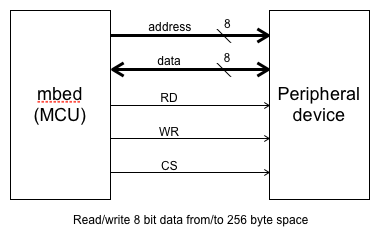

It's like a traditional parallel bus with a direction line (or lines) separate from the address lines; eg,
https://os.mbed.com/users/nxp_ip/notebook/parallel-bus-access/
@John E KVAM wrote:But when writing a manual does one use the base address or the write address?
One should use the one & only 7-bit address.
If you are combining the 7-bit address with the R/W bit into a byte, then make that clear.
[/rant-over]
* Not considering 10-bit addressing!
