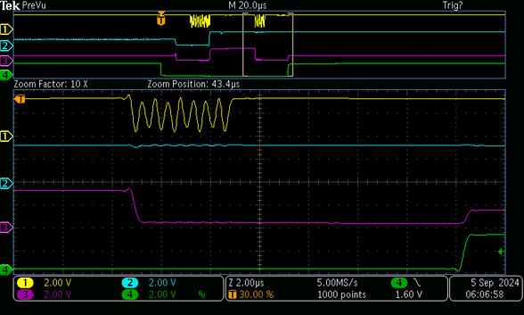

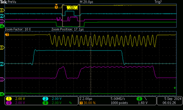

The firmware reads the "device_id" and "revision_id" from the sensor in the vl53l8cx_is_alive() to determine if the sensor exists. The return values different every time I tried to read. I was able to capture the protocols on the scope, and confirmed the reading values are match with the data shown on the scope. The following scope capture shows the communication:
1. Sending 0x00 to address 0x7fff. The yellow signal is for the MCLK, blue for MOSI, purple for MISO, and green for /CS.
2. Receiving 0x0 from address 1 for "revision_id".
3. Another reading 0x4 from address 1 for "revision_id".

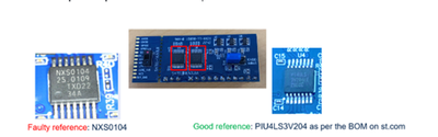

This happened to the ST VL53L8CX Satellite board as well.
Issue : SPI communication is not working when SATEL-VL53L8 (PCB4286A) is connected with flying wires to the NUCLEO-F401RE Root cause of defection : Supplier populated 2 Level Shifter references for all SATEL-VL53L8 - 1 level shifter reference is incorrect specification. Visual check of the boards is needed to identify Level Shifters references (U4 and U6 component)
Workaround : None possible – only a replacement of the level shifter will fix the issue. |
I don't know if it's your exact problem as I've yet to see the Pololu board, but it's a fair guess.
ST is trying to pull back the affected boards, but it's a real mess.
Level shifters are a pain on I2C. I hate those things. I hope this is not your problem; but do check it.

Do a visual inspection of your pololu board and check the reference of the level shifter.
The BOM shared on st.com references the right LS Part Number. So if pololu took this BOM it should be OK.
Wrong boards manufactured by ST supplier will be reworked with the right LS.
At the end, reworked boards will be identified with a new part number.
Anyway, a replacement of the faulty board is planned in case of issue.

I got SATEL-VL53L8 sensor board with wrong level shifter "NXS0104". I had the same issue I was facing. Replaced the level shifter with correct one - "PI4ULS3V204". I was able to get device id, revision id, and completed the sensor initialization. Thank you very much.
