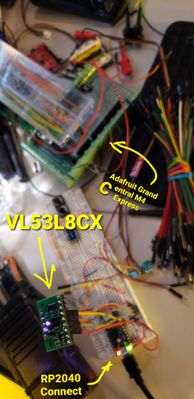

This is good to know about the initial power draw. I just went through a weekend of trouble because of my sketchy wiring on a breadboard but was finally able to get the VL53L8CX working in both SPI and I2C to an Arduino Nano RP2040 Connect. Used USB power and 3.3v from the RP2040 for the sensor. So far so good.
Note to all, keep trying, it works. Can't wait to try them on my robot. Have 20 more on the way.
