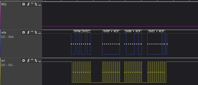

As shown in the figure, VL53L4CD_ClearInterrupt was called, but the interrupt pin still is at a low level. I have tried that under normal circumstances, after calling VL53L4CD_ClearInterrupt, the interrupt pin will become high level

I think I've seen that. There is a trick. One has to clear the interrupt, then issue the stop command. If you issue the clear interrupt while the ranging engine is stopped the engine is not paying attention and you end up in this situation.
But it's trickier than that. Unless you have the absolute latest driver the stop as implemented is "stop after the current range completes". And that could be 20ms AFTER you issue the stop command. And after that last range, the interrupt will be triggered, and you can't clear it - because the engine is now stopped.
The solution is to get the latest driver. We implemented the stop as "abort the current range and stop."
Thus, you can get the interrupt, read the data, clear the interrupt and 'STOP NOW'. The engine will halt without completion of the current range, and it will not trigger that last interrupt.
