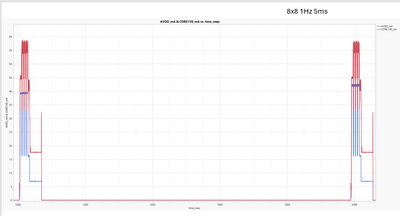

I had someone I trust recheck it.
And he gets a plot more in line with our datasheet:
I'm not sure you can read that but it's a plot of AVDD and 1.8 in mA. And it goes from a high of almost 60 and down to very near zero.
He also commented:
"However their core_1V8 is a bit higher (still in spec).
"AVDD is much lower and a little concerning. Too low and we will not fire the laser.
"It’s almost as if it is collapsing. Which can happen if there is too much signal such as a very close bright target (e.g. halogen lamp).
"I get approx.1.9mW on 4x4 at 1Hz (2ms int)
"Important to make the measurement with only the L8 on the supply not other devices powered at the same time."
I'm a software guy trying to interpret this, but I'm hoping this helps.

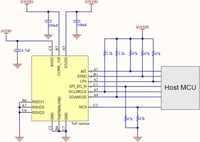

"Normally the switch is automatically cleared after 100μs, and the sensor automatically goes into low power mode. It seems that the customer can see this kind of thing (even if the power is higher than expected). It's rather positive, it shows that it's not a SW or FW problem.
We are left with the HW. Can you confirm that all the pins are well connected as advised in the DS? No floating pins or any particular setup?"
I agree there isn't much one can do wrong in the SW. So, let's start by double checking the HW.

2024-09-05 8:00 AM
He also commented:
