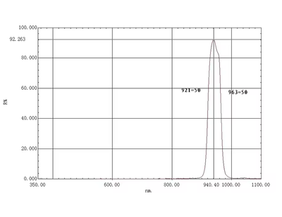

So. Just how good?
Do you have a spectral response?
Here's an example of a relatively narrowband 940 nm Filter, about $2.00 in 10 mm square size
