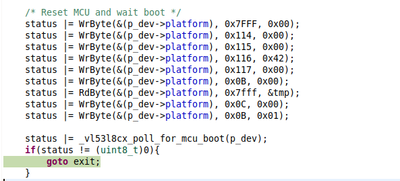

Currently i'm trying with a 2.5 MHZ SPI clock but the init is crashing here :
