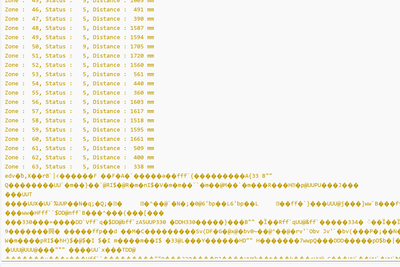

Hi, currently I can use the dma through ef_add_int32 and ef_add_int8 function to transmit the data to my computer, but I don’t know how to decode it. Is there any good method to decode the data? The function is shown below:
void ef_add_int8( int8_t data ) {
if ( (g_curr_pos + sizeof(uint8_t) + 1 + sizeof(g_suffix)) > EF_BUFFER_SIZE ) /* overhead includes CRC byte */
g_error_detected = true;
if ( g_error_detected )
return;
g_frame[g_curr_pos++]=data;
return;
And the data I get looks like:
The above data are getting from the printf and the data on the buttom is the data from DMA
