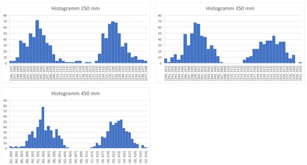

The third issue I could see after aquiring some data, was that the measured distance of one sensor is somewhat odd distributed...
I coud provide you a screenshot of the histogram of a white target @250, 350 and 450 mm distance. X-Axis is measured distance, Y-Axis is how many times the range was measured, each one is result of ca. 1000 measurements.

Given the clustering of your data, I'm going to take a guess.
At each 'start' command the sensor does a 'phase detect'. and it sure appears that you are coming up in one of two phases.
(This guess assumes you didn't do one 'start' and a lot or ranges, but did at least a few 'start/stop' operations.
Find the parameter #define VL53LX_TUNINGPARM_PHASECAL_PATCH_POWER_DEFAULT in the VL53Lx_tuning_param_defaults and see if increasing it helps.
Try 2 to start.
Note - this WILL delay the time until first_range_complete as it spends more time calculating the range.
See if the data gets bettter and if you can live with the delay.
