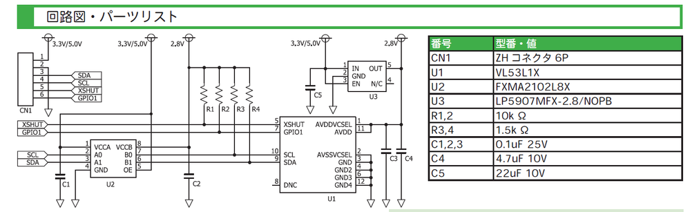

There are only 2 ways to reset the I2C address. Toggle the power, or toggle the XShut line. But it doesn't take much of a toggle. An EMI hit on either line could do it.
I'm thinking larger caps and stronger pull-ups might fix your issue. And putting those caps as close as yo can is a good idea too.

Regarding your suggestion of using caps and pullups, could you please suggest what additional values should I be using to avoid this issue. I'm also attaching the schematics of the VL53L1X sensors that I'm using.
