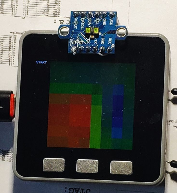

The trik is that I interpolate initial 4x4 array of 4x4 SPADs to 8x8 array.
