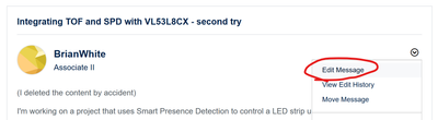

2025-01-25 9:12 AM
> It seems that the SPD code makes extensive use of function calls to control the sensor using the VL53LMZ_ULD_API but these calls do not work in the context of my existing project
What makes you think it doesn't work in the context of your existing project? What error messages are you getting?
It's better to post specifics. Most code can work alongside each other, especially if they're independent pieces.
(For next time, you can edit your post here rather than reposting.)

2025-01-25 10:43 AM
TDK
Thanks for the quick reply and for the editing tip.
