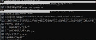

Based on your CMD screenshot, your yaml is using an operation mode that at least contains quantization and benchmarking.

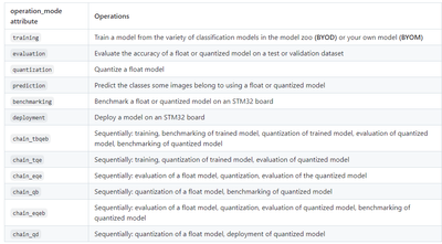

As for the deployment, if the operation mode contains the deployment (so deployment or chain_qd, see the tab in my first post), if your board is plugged, a basic application and your model will be deployed on your board.

Just to put some context, the idea behind model zoo is to configurate the user_config.yaml to do a lot of things:
So the idea is to edit the user_config.yaml and use the python script stm32ai_main.py, not to use the deploy.py.

Note that with the other operation modes. You can benchmark and evaluate your model before quantization, then after to compare them for example.  There are also chains operation modes to do multiple things in one go...

Hi Julian, thanks a lot for your very detailed and helpful reply. It looks like quantization is enabled by default in stm32ai_main.py, so is the benchmarking.
I believe that the benchmarking is done on the cloud, judging by this line in "stm32ai_main.py" and the "credentials" requirement?
