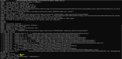

Hi @Julian E., not sure if this will help but I get this return code error when I try the aforementioned method of deployment

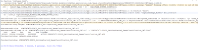

I've tried downloading a new version of the stm32 model zoo and trying the deployment again both with the 'deployment.py' file and through STMCubeIDE. I am not getting the previous LCD fatal error but rather these warnings. I have tried using STMCube version 1.13, 1.10, and 1.16 but to no avail.
C:/Users/harth/Downloads/stm32aimodelzoo/stm32ai_application_code/image_classification/Application/STM32H747I-DISCO/Src/CM7/main.c:236:3: warning: 'memset' forming offset [153600, 153631] is out of the bounds [0, 153600] of object 'CapturedImage_Buffer' with type 'uint8_t[153600]' {aka 'unsigned char[153600]'} [-Warray-bounds]
c:\st\stm32cubeide_1.10.1\stm32cubeide\plugins\com.st.stm32cube.ide.mcu.externaltools.gnu-tools-for-stm32.10.3-2021.10.win32_1.0.0.202111181127\tools\arm-none-eabi\bin\ld.exe: warning: section `.bss' type changed to PROGBITS

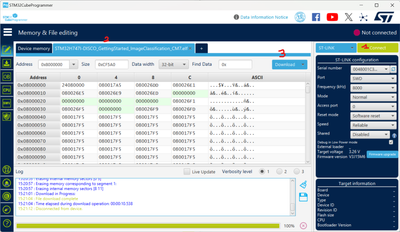

We will try something, download the .zip file attached which contains the cm7.elf.
Open STM32CubeProgrammer:
Does it work? If not there is an hardware issue.
If it works, something is wrong with what you did, so here is the exact process:
First, make sure you have this exact hardware:
Then use a micro usb to usb A cable (in other context, I've seen issue with usb c cables). Make sure your cable is data.
Plug and unplug your camera (maybe it is not well pluged).
Then with model zoo
Once everything done:

Hi @Julian E. ,
I am happy to inform you that the cm7 file you provided works for me. Following the steps you provided works as well. I had an extra board and camera, I think my camera may not have been working previously hence the error I was obtaining and the strange LCD display. I'm not exactly sure how the camera broke, but I got a spare one now. Thank you very much for your support.
